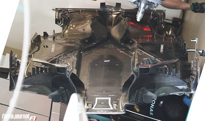

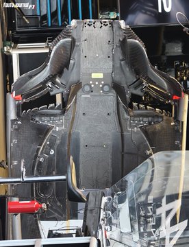

Nice views of the Alpine A521 and Mercedes W12 floors in Baku.
#F1 | #TechF1
